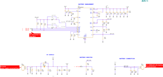

Here is the schematic of the BMIC circuit with battery and PSU connections highlighted.

    It's helpful to know that this issue only occurs while VBUS and BAT are connected. I double-checked your register dump and schematic, but I don't see any obvious issues.

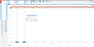

    I took some traces of VBUS, VSYS and VBAT when in the condition of the CONV_START bit being stuck..
    So here is the trace when CONV_START is set and remains set.
    There's a dip on both VSYS and VBAT every ~43mS. I'm sure if this helps at all or is even related

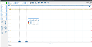

    and for comparision here it is normally
    Thanks again for your help so far.. Have a nice weekend!

  • Hi Trevor,
    Thanks for sharing these waveforms. They're very helpful and related to the ADC behavior you're seeing.
    The ADC in the BQ25892 operates by sampling the input signal over a period of time and averaging those samples to produce a stable reading. For this process to work correctly, the input (such as VBAT) needs to remain relatively stable during the sampling window.
    If VBAT has excessive ripple or is changing rapidly, the ADC cannot settle on a valid result. Since the input is varying too much while the ADC is trying to measure it, the final reading may not accurately reflect the true voltage or no valid reading may be produced at all.
    Do you know what's causing the oscillations in the waveform where the issue occurs? For example, is a pulsed load being enabled? If we can get those waveforms to look cleaner, we can resolve the ADC issue.
    Have a nice weekend as well!
    Alec
