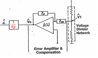

I am designing a voltage mode control. I need the value of KPWM = 1/Vpeak of the oscillator. For UC3843, Vpeak is 1.7V?
Yes it is typically 1.7V as specified for your presented circuit.
