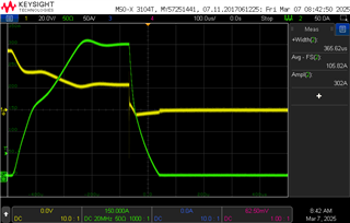

Hello, we were doing some testing on the fuel gauge IC, testing the hardware protection, and we're finding the results aren't matching the register settings.
We've currently set our to SCD2=0x23. This should be giving us a delay of 61us above 222A with the resistor value used for testing. But currently it seems like it takes a lot longer than that.
Also would appear that the FG waits for steady state on the current before applying the threshold, can you confirm if this is the expected behavior?
Green = Current.
