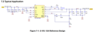

TPS51388: What is BFG pin used in TPS51388
Part Number: TPS51388
Hi Team
in Table 4-1. Pin Functions, FBG pin mentioned "Ground of internal analog circuitry. Decouple this pin to ground with a 4.7μF ceramic capacitor or leave the pin floating. Connect to Rfb_low if wanting to improve load transient performance."
in reference design, FBG directly connected to GND without 4.7uF.
In schematics design, should we need to reserved anything? or just follow reference design connected to GND?
