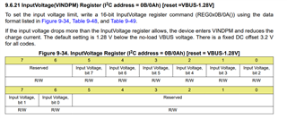

  • Hi Aya,
    How can I get the system to turn off at 10.8v?
    on page 26 of the BQ'31 IC, it states:
    "Host can adjust VINDPM threshold after device POR through InputVoltage register(0x0B/0Ah[]), range from 3.2V to 19.52V with LSB 64mV."
    Are we able to set this using the customization tool? I'm using an SLA battery.

    The system currently does not support setting the VINDPM register to a fixed value. Setting this is not an option in the customization tool. The VINDPM register is currently being used to actively prevent UVLO due to excessive current draw. The value get's programmed based off of the active PD contract and changes with PD contract voltages.

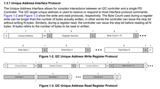

    Also,. I've tried to read back some key data through the I2Ct line, but the numbers are always incorrect.
    Can you elaborate? Share an example of what you are reading and what you are expecting.
    Keep in mind the I2C payloads have a specific format. (image from TRM)
    And if I have to use an MCU to set some BQ registers, which of the i2c lines should I use? And should I keep the eeprom IC or discard it?
    If you use an MCU, it would depend on the application and how much control you want. If you want the PD controller to maintain some control over the BQ regarding the active contracts and power, you would want to leave the TPS25751 I2Cc connected to the BQs I2Ct lines. In this configuration, you can leverage the I2Cw and I2Cr 4CC commands to write I2C through the tps25751 to the BQ if and when needed.
    If you want full control, you can remove the TPS25751 I2Cc to BQ I2Ct I2C connection, and have the MCU directly connected to both devices I2Ct lines.

  • Hi James,
    VINDPM doesn't seem to be the right register for UVLO.
    Do you know what register might be affecting UVLO? I primarily support the PD controller devices, and am by no means an expert with the BQ parts. You had mentioned it in the past to Aya so we were checking there. I'll also check internally. VINDPM does seem to affect some form of undervoltage monitoring, but if it is not the correct register, please let us know.
