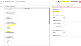

    Yes and No.
    First, you need to add a PPS sink PDO and enable Sink PPS through the Advanced config portion of the GUI.
    Adding the PDO (Increment number of PDOs and configure as shown)

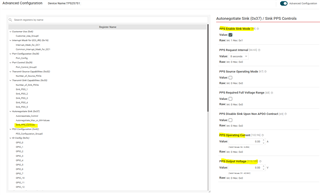

    Enable Sink PPS and set desired voltage and current
    PPS is intended to be used with an MCU that can update the operating current and voltage in real time. You can set an initial operating voltage and current for the PPS contract, but if the attached source does not advertise the contract requested, the PD controller may try to negotiate the max fixed PD contract.
