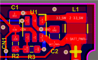

I am using a TLV61220DBVR in circuit and am having problems with input current instability.
Vin = 1.4V, Vo = 3.3V, Io = 25mA max. AA lithium battery (1.3V-1.5V) to boost to 3.3V. The load is a regulated laser module that draws 20mA typ. Using a bench supply for input for this testing.

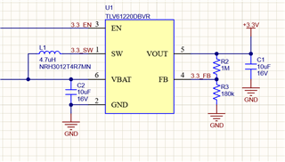

Schematic

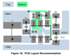

I have followed the layout recommendation in the datasheet exactly (after failing to do that the first rev and having even more problems)
I've tried upping the inductance and that doesn't seem to help anything. Inductor: NRH3012T4R7MN
Is there something I'm missing or I should try next to investigate? I've been trying to figure this out a while.
