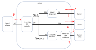

  • Hi Chris
    Could you share a block diagram of what you are thinking? I don't completely understand what you are looking for, one input, three outputs? What are the inputs and what are the outputs?

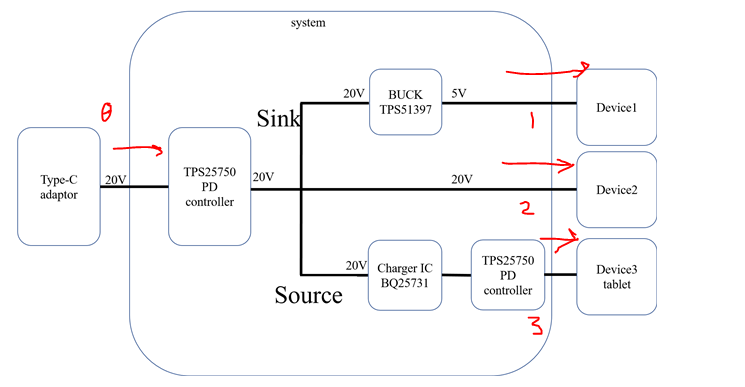

    The fallowing is my simple block diagram for your reference.
    My input is a 20V type-c adapter,After passing through the first TPS25750 in the system, it needs to be divided into three different paths.
    The first line needs to step down to 5V to charge device1. Do I need a Buck to step down or can I control the charging voltage through the charger IC in device1?
    The third path is to charge the tablet through the PD protocol. The tablet has a Charger IC. Do I need to use the Charger IC BQ25731 in my system?

  • Hi Jing-Ming,
    Is there a battery in the system? I'm a little confused about what the BQ25731 is used for.
    How are you regulating system power? Is the type-c adapter always guaranteed to provide a certain power level? How are you making sure that the power draw from the three ports does not exceed what has been negotiated at the TPS25750 sink port?
    Is the type-C adapter guaranteed to source 20-V? Understand that for typical type-C PD, we can and will negotiate lower voltage contracts if that is all that is available. Also, every type-c contract will start with a 5-V contract. your implementation of the 20-V rail to device 2 may be of concern.
    You probably need a dedicated 5-V buck for device1. I'm not sure how the charger IC (Bq25731) would regulate the 5-V for Device1. I mainly support the PD controllers so may be missing something here.
    With the above block diagram, if I replace TPS25750 with TPS25751, can I directly control the BQ25731 without using an additional I2C interface?
    It can control it for basic PD and configuration. We do not support custom I2C writes and it is primarily for general setting configuration and programming voltages and currents based off of active PD contracts. If you need additional features, and I2C host (mcu/ec) may be required.
    What is the biggest difference between TPS25750 and TPS25751? Can you give a brief introduction?
    PD 3.2 compliance and future support. The TPS25751 is a direct successor so should support all the same features and is p2p. We will not be able to support the TPS25750 for new designs.
    Depending on your answer to the guaranteed power from the sink port, you may need to address power management concerns in this system. I don't see how you will limit power draw to not exceed the sink port.

  • Johnny,
    There is no battery in my system.Because one of FAE told me If TPS25750 is used in source, it needs to be used with Charger IC,when the sink side is not needed.
    Ok, where is system power coming from? Is it just coming from the 100-W port?
    This is a charging device whose input is type-C with a maximum of 20V (100W) and the TPS25750 also sets the source & sink to a maximum of 20V (100W).
    If this port is system power, it should be configured as Sink only. As mentioned before, unless you can guarantee that the Adapter connected to this port will always provide 100-W, you need to account for cases where the PD controller may negotiate a lower power level and limit device power draw accordingly. The TPS25751 does have a feature to disable the sink path if the contract negotiated is not above a certain power level, but this will mean your system will not power up at any lower power level.
    For Device 3/tablet, is the port source only? What voltages do you need to support? For the TPS25751, we only support source only configurations if it is 5-V source only. If you are doing 5-V source only from port3, you would not need a BQ device either, just a 5-V rail connected to the PP5V pin.
    Thanks and Regards,
    Chris

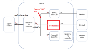

  • Hi Johnny,
    If I understand correctly, power flow should look like this? I labeled the ports 0,1,2, and 3 just to make referring to them a little easier.
    A buck boost between the output of p0 and p2 is only necessary if you can't guarantee 20-V from the Type-C adapter. Is p0 meant to work with any adapter, or is there a specific pairing you are expecting.

  • Hi Christopher,
    Yes,that's right,What you drew is the same as what I expected.Is there something I haven't considered with this approach?

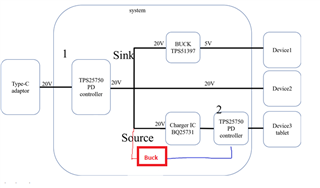

    I have pre-selected a type-C adapter that supports the PD protocol. According to the design, I think any type-C adapter that supports the PD protocol can support my charging dock.
    As shown in the figure below, I would like to ask, PD controller No. 1 is activated by connecting to type-C to obtain V-in 3.3V. Do I need to pull another line to output 3.3V to PD controller No. 2 to activate this PD? Or can the Charger IC provide a set of power to activate PD controller No. 2?

  • Hi Johnny,
    Outside of what I already mentioned (Power management to not exceed input power and potential concerns with 20-V rail to device 2), no.
    Not all Type-C PD adapters support 20-V. Some will do 9-V or 15-V max. If this is the case, how do you expect to generate the 20-V rail?
    There are also a range of power levels, from 15-W max to 100-W max. How will your system handle different power levels?
    I would recommend generating a 3.3-V rail off of the system voltage rail. It may need to be wide input (5-V - 20-V) depending on how you handle the input PD contract from port 0(100-W max sink). You should not use the LDO3V3 output of the TPS25751 PD controller 1 to power VIN3V3 of other IC's. The LDO3V3 pin is primarily meant for the PD controllers EEPROM and for I2C pullups.
    I'm not familiar with the Charger IC, but it would need to provide a 3.3V rail to VIN3V3 to power PD controller 2.
    If the Charger IC can provide Vin 3V3 to PD controller 2, then do I not need to pull another 3V3 power supply from the system to PD controller 2?

  • Hi Johnny,
    When selecting an adapter, I will determine the output voltage and maximum power (e.g. 20-V, 100-W).If there is the 9-V or 15-V condition mentioned above, I will place a charger IC on the P2 path to adjust the voltage according to your suggestion.
    For the P2 path, if it a single direct 20-V, you may be able to get away with a boost/buck-boost.
    If the Charger IC can provide a constant 3.3-V off of the system rail, and is always powered when you need the PD powered, yes, it should be fine.
    If my adapter is a 20-V 100-W maximum, I can set the voltage to be fixed at 20-V through the TPS25751 GUI and output it to my subsequent system.Is there any mistake in my understanding?
    Yes this is correct. The TPS25751 will negotiate a 20-V contract with the adapter and close it's power path, allowing the adapter power to flow to the system side.
    I sorted out the above two points. The following is my understanding. Please help me check whether it is correct.
    If the adapter I use is a 20-V 100-W maximum and the output is set to 20-V through the TPS25751GUI, then the P2 path does not need to be buck-boosted. If the adapter is a 5-V, ​​9-V, or 15-V adapter, then a buck-boost needs to be added to the P2 path.
    Yes, that is correct if you want the P2 path to always be 20-V.
