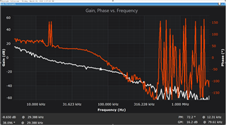

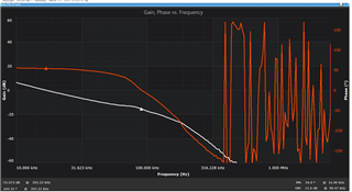

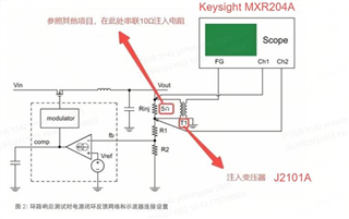

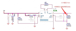

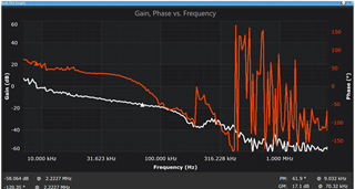

Customer have tested our TPS631000EVM and TPS631000 in their PCB board, please check their schematic, test set-up and results to see if their test is good.
Schematic: 10ohom resistor here
Test set-up:
Results:
TI EVM
4.4Vin 0.5A Iout
Customer board:
4.3V Vin, 800mA Vout
3.3V Vin, 500mA Vout
Thank you,
