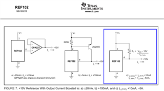

Is the REF102 a good choice for that application ? I am referring to the picture below taken from the part data  sheet.
Can you help indicating the complete circuit to be added to REF102 in order to boost the current accordingly?

    For 200mA output current, you could use a variation of any of these three options if you correctly choose components (i.e. op amp, transistor, resistor, etc.) for the current rating that you desire. I would recommend option A or option B because then you don't have resistor tolerance concerns that would be present in option C that could degrade accuracy performance further. For a 10V fixed output, REF102 is a good choice, or REF5010IDGKR (REF50) is also another good choice.

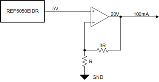

    For 20V output, you would need to increase the output voltage using an op amp. For this, I would recommend REF5050EIDR (REF50E) with an op amp which can provide the required accuracy and also source 100mA of current in a 4x gain configuration on the output of REF5050EIDR.

    I believe that example in Figure b is the more recommended for extensive current capability.

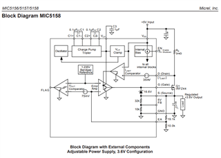

    In the meantime we found the part from MICREL MIC5158 for additional features that would work for us: uses external MOSFET for high current, Sense Resistor for monitoring the load current, Flag Indicator for a fault condition.

    With the right transistor, you are correct that figure B can likely source more current. What is your accuracy target? This will be helpful in recommending the best device.

    2. 20V 100mA Reference Voltage (Op Amp suggestion: OPA2156)

    The preferred solution should be in a configuration similar to the MIC 5158, with the accessible features that I listed about this part: external MOSFET for high current, Sense Resistor for monitoring the load current, Flag Indicator for a fault condition.
    Even though the LDO does not have the highest accuracy, we can select the external components/resistors to contribute to the overall circuit accuracy.

    We do not have a part with a dedicated pin to gate voltage like the MIC5158. (There is technically way to wire a BJT across an LDO to amplify the current which maintains regulation because of the LDOs negative feedback, but I haven't seen it used beyond the LM317 nor adapted to a MOSFET). Typically, we just recommend a part with a higher current limit for higher current applications.
