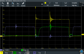

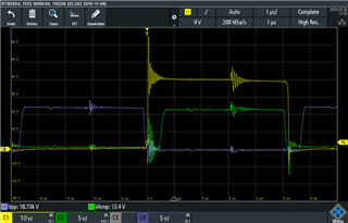

I have ruled out these hypotheses by analyzing the following signals in the lagging and leading leg:
  • Blue: Voltage at the low-side MOSFET gate.
  • Green: Voltage at the high-side MOSFET gate.
  • Yellow: Voltage at the intermediate node of the branch.
As shown, there is no crossing between the gate signals. Moreover, the waveform indicates that this branch is performing soft switching. First, the low-side MOSFET gate is turned off, and shortly afterward the voltage at the intermediate node changes from 0 to Vin. If I am not mistaken, this behavior is due to the shim inductor forcing the continuity of current, which causes the low-side MOSFET’s capacitance to charge and the high-side’s to discharge. After this process, the high-side MOSFET gate is activated (with ZVS already achieved), and finally, the high-side MOSFET is also turned off under ZVS conditions.
I am attaching the corresponding images for the lagging leg and the leading leg, as well as an image showing the MOSFETs heating up:

  • The dead time between high and low side seems to be high for me. You mentioned that you managed to get waveforms with much lower noise/ringing. Can you share that instead?
    Why do you think the temperature is too high? Do you have any reference to show much lower temperature?

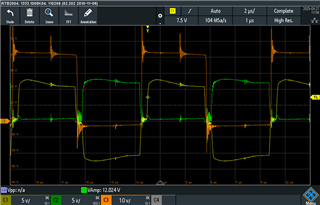

  • Dear Ning,
    Thank you for your response.
    Indeed, the dead time seems quite high, and both legs appear to be achieving ZVS, which by the way I find unusual given that the load was only 3A and the shim inductor was minimal (220nH).
    Regarding the waveforms you requested, I have attached a screenshot below.
    As I mentioned earlier, I conducted a test where I connected the primary and secondary grounds together, driving the low-side MOSFETs directly from the driver. For the high-side MOSFETs, I continued using gate drive transformers to generate the 12V from source to gate. In this test, the noise observed in the high-side MOSFETs (yellow trace) was almost negligible, yet the heating issue persisted.
    Due to this setup, the low-side MOSFET gate voltage only swings from 0 to 12V, while the high-side MOSFET gate voltage varies from -12V to 12V since it is driven through the gate transformer.
    The following image represents the waveforms of the leading leg MOSFETs:
    • Orange: Voltage at the intermediate node of the branch.
    • Green: Voltage at the low-side MOSFET gate.
    • Yellow: Voltage at the high-side MOSFET gate.
    As seen in the waveforms, the MOSFET directly driven by the low-side driver exhibits significantly more ringing compared to the one driven through the transformer. However, the ringing in the high-side MOSFET remains below 2V at all times, meaning it is insufficient to turn it on.

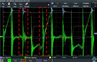

    Regarding your question, "Why do you think the temperature is too high?"—I believe the issue is not with how the FET gates are driven but could be related to the body diode. There may be unwanted currents passing through it, or possibly reverse recovery effects causing excessive heating.

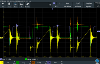

    Until now, I have only been monitoring the MOSFET gate voltages, which do not reveal everything. If abnormal current is flowing through the body diode, it may be hidden from my observations. To gain better insight, I placed a shunt resistor in series with the high-side MOSFET of the leading leg to monitor the current flow for any irregularities.
    The following image shows:
    • Yellow: Current through the MOSFET.
    • Green: High-side MOSFET gate voltage.
    • Blue: Low-side MOSFET gate voltage.

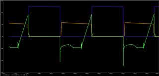

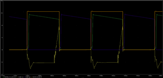

    For comparison, I have also included a simulation under similar conditions.
    Additionally, I want to emphasize that I am using a current doubler topology for rectification. At the time, I verified that this controller should be compatible with this topology, even though it is not the one shown in the datasheet (which presents a full-wave rectification phase with a center-tapped transformer).
    However, since I am encountering an issue whose cause I have yet to identify, I need to consider the possibility of a conceptual error. Therefore, it would also be helpful to confirm whether my topology is indeed compatible with the UCC28951.

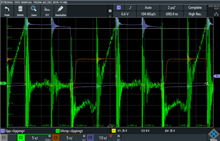

  • Hello, as an update:
    To obtain more information, a shunt resistor was placed in series with the low-side MOSFET of the leading branch to measure the current flow.
    The following waveforms were obtained from the measurement:
    • Yellow: Current through the upper shunt (A).
    • Green: Current through the lower shunt (A).
    • Orange: Gate voltage of the low-side MOSFET.
    • Blue: Voltage at the middle node.
    A very intense ringing has been identified at moments when the MOSFET channel is off. This indicates that current is flowing through the body diode, both in forward and reverse bias. Although these periods are in the nanosecond range, they could explain the heating that has been observed.
    The most concerning peaks coincide with the switching of the MOSFETs in the opposite branch, which is not shown in the oscilloscope capture. This suggests that the noise is being injected from one branch to the other.
    At present, the origin of this ringing is unclear. One hypothesis is that it may be related to the physical design of the assembly or the PCB layout.
    When comparing the experimental waveforms with a simulation of the same circuit under identical conditions, it was observed that, aside from the noise present in the real implementation, the current waveforms through the MOSFETs match.
    The theoretical circuit does not exhibit ringing, but it does appear in the physical implementation. Therefore, the issue could stem from the PCB design or the way the components are arranged.

    That said, I don’t believe the issue is related to the Rdson of the MOSFETs, since the problem appears even at just 3 A of output current — far below the 80 A the converter is designed to handle.
    As shown in the last three images I attached, significant current oscillations appear across the full-bridge MOSFETs while their channels are off. I suspect this is the source of the excessive heating. What I haven’t been able to determine is what’s causing these oscillations. They occur whenever any of the four FETs are turned off, and the voltage at the switching node shifts polarity (from 0 to Vin or vice versa). This shift is likely due to the charging and discharging of the parasitic capacitances in the MOSFET branch, driven by the current briefly sustained by the transformer’s leakage inductance. This rapid voltage change may be triggering oscillations, as the inductance in the current path resonates with other parasitic elements.
    If that’s the case, I’m unsure what changes I could make to the schematic to suppress these oscillations.
