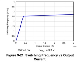

I have a question on the switching frequency range of TPS62132RGTR.
I found this figure on your datasheet, which shows that the switching frequency decreases
according to the amount of output current. From this figure I can read 2.5MHz@400mA,
so 250kHz@40mA if I estimate the value proportionally.

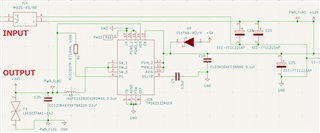

 With my application,
Vin: 12V
Vout:3.3V / Iout:30-50mA
Cin:10uF / Cout: 22uF / Lout: 2.2uH (as recommended)
I observed the switching frequency of approx.6kHz, which is
much lower than the estimation above. (Waveform:Vout)
Now questions are:
1. what switching frequency shall I expect, as a design value or a typical value, at the current range of 30-50mA?
2. Is there any lowest limit of the frequency,  or is it really 0Hz at 0A?
3. If possible, can you judge whether my waveform is normal or not?
