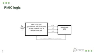

Application detail:
We are looking for a Power Management Integrated Circuit (PMIC) that can provide 3.3V, 1.8V, and 0.9V outputs. This PMIC must include an internal Real-Time Clock (RTC) to manage the power-up sequence of its outputs. To power down the PMIC, our System-on-Chip (SoC) will assert a 1.8V signal to the TPS650250.
For any queries feel free to contact us.
TPS65910 - How to wake up the platform / SoC using RTC_PERIOD_IT / INT_TIMER.
Please find the simplified block diagram in the attachment.
Kindly suggest a suitable  Dual Buck converters TPS62441-Q1.
Note : Following PMIC / Dual Buck Converter going to incorporate in Mindgrove EVAL Board/ ASIC Boards/ SOM.

  • Hi Ismail,
    Thank you for reaching out on E2E! Could you clarify a few things for me, are you looking for a replacement for TPS650250?
    What are the current requirements for each rail? Do they all need to be bucks, or are LDOs acceptable?
    TPS65910 and TPS65911 devices include an internal RTC.
    TPS659118 has a preprogrammed sequence for 3.3 V (Buck) → 1.8V (Buck) → 0.9 V (LDO). More information can be found in this User Guide
    One thing to note, our devices are able to control power up sequence of the output rails without a dedicated RTC oscillator, if this is the sole purpose.
    Custom sequence and voltage requirements can be programmed to user-programmable device TPS6521905 .
    TPS6521905 can be shutdown by the SoC via the RESET/EN pin inputs.

  • Hello Mr. Sathish,
    The above part code TPS650250 application note is not providing enough information to conclude. I felt there is a small gap in understanding our application.
    Let me Rephrase it: PMIC used to Power down our Mindgrove Application board wrt the enable signal (1.8V) received from the Mindgrove Soc.
    For  power-up the Mindgrove Application Board in 2 modes. ( both modes implemented in simultaneously)
    * Auto Mode: Once Mindgrove App board needs to wake up after a power down event, using either a RTC or timer to control the wake up time
    Example sequence: Application Board--> Power Down Signal from SoC--> PMIC disable the rails--> Interrupt generate from RTC ( In-build with PMIC)--> PMIC enable the rails.
    *Bypass Mode: When Mindgrove App board is power Down, it need to Power up (wake-up ) the board wrt the External switches (ex: Touch display or Push button)
    Sequence: Application Board--> Power Down Signal from SoC --> PMIC disable the rails--> Interrupt generate from  Push button ( external one)--> PMIC enable the rails.
    Ismail P

  • Hi Ismail,
    TPS650250 provides individual enable pins for 3 converters and a combined separate input for LDOs. I don't see an option for auto power up after a power down event.
    TPS6521905 (user programmable version) can be configured in push button mode and when RESET pin is configured in COLD RESET it can power down all the rails and power up automatically but there is no option for programmable time between power down and power on.
    Sathish

  • Hi Ismail,
    Please take a look at this device TPS6593-Q1 which has RTC to wake up. If the device meets your requirements, please submit a separate e2e so that device expert can support.
