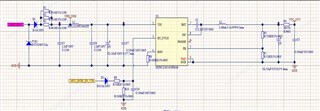

My customer use LM5168 with VIN 30V, VOUT 13.3V, when they increase current load from 0A to 10mA(electronic load CC mode), the VOUT will collapse to very low voltage about 3V-4V.
I test output voltage and current ripple, seem to be abnormally larger. So I add 100pF Cff, then it can work well. Not sure if there is something wrong with the circuit, such as loop stability?
I found datasheet show we can use lowest cost circuit without any Cff or RC
Pls help comment that. Below is schematic, note: customer actually use LM5168FDDAR, not LM5163
BR
Amber

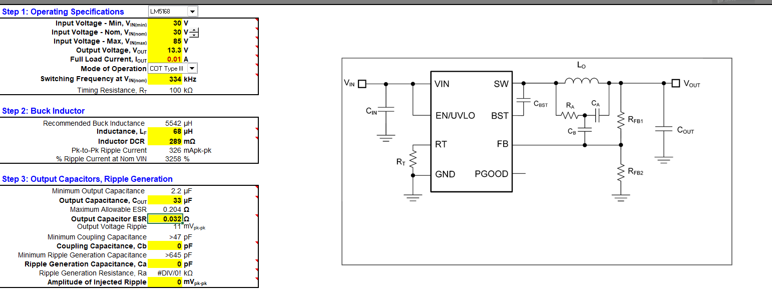

  • Hi Amber
    Could please fill Quickstart - SNVR520 Calculation tool | TI.com to help with the review.
    Thank you
    Onkar Bhakare
  • Hi Onkar,
    I fill the excel as below, I found ripple current calculation is 324mApk-pk, is that too large to cause my above issue? seems that is still below current limit in datasheet if current load I set is 10mA.
    and I don't want to ripple generation circuit so I remove Cb Ca Ra, not sure if it is suitable? voltage ripple is 11mV in calculation, but actually I test ripple is 60mVpk-pk with oscilloscope

  • Hi Amber
    - As you are using electrolytic capacitor at the output, it's ESR might be able to provide sufficient ripple for the proper operation
    Can you provide datasheet of output electrolytic cap to confirm this?
    I see you are using FPWM version, there is possibility that negative side current limit will hit
    Could you please probe inductor current waveform along with SW and Vout?
    Thank you
    Onkar Bhakare

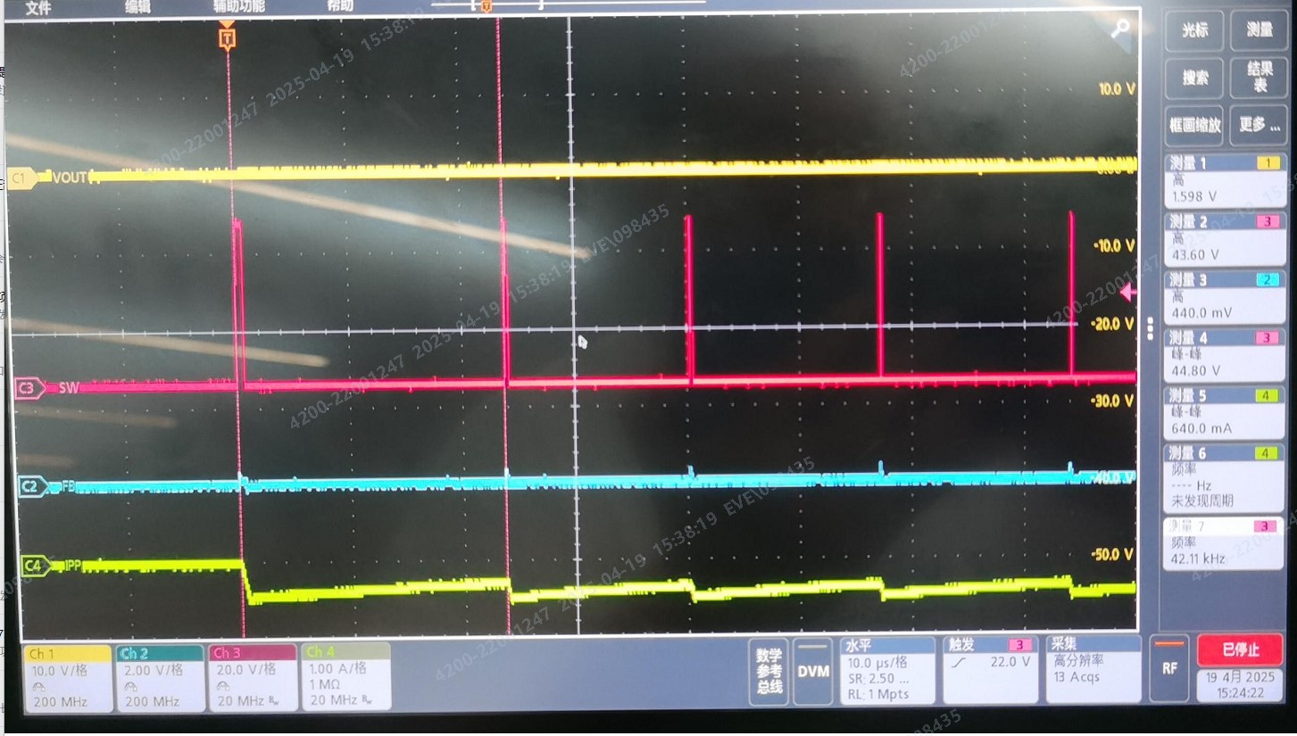

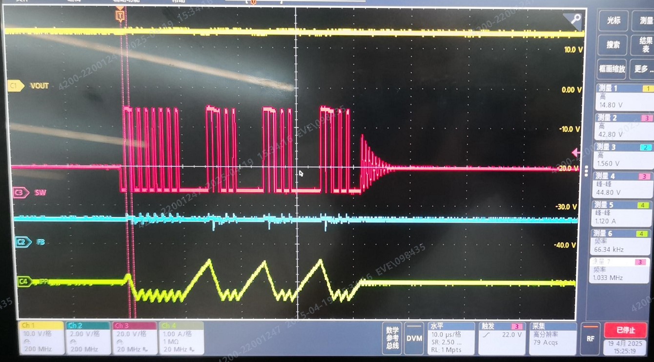

  • Hi Onkar,

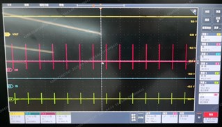

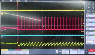

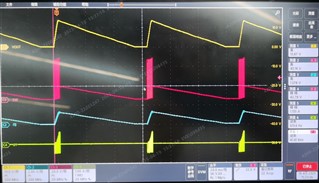

    I get back to you with further test waveform VOUT/SW/FB/current through inductor  :
    0A output current:
    Zoom out:
    Zoom in:
    5mA:
    Zoom out:
    Zoom in:

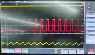

    10mA:
    I found peak to peak of inductor current is very higher(actual value is >1A) than I calculated on the table, and it mostly like hiccup mode which has duration of ~64ms according to above waveform?
    Why Ipp is so high than calculation value, and what can I do to solve the issue? increase inductance(68uH now with 1.1A saturation current, I=do you think Isat of inductor is also low )?
    I found if I add Cff of 100pF, current and voltage waveform can be normal, below is 150mA waveform(peak to peak current is 520mA, a little reduced but still higher than calculation  )
    BR
    Amber

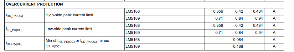

  • Hi Amber
    This looks like instability issue. Vfb is not seeing enough ripple to function properly. Thus, adding Cff is helping. Additionally, this leading to current limit violation.
    You can do either of the following changes to function it properly
    1. Add ESR of 700 mOhm in series with output capacitor, but it will increase the output ripple
    2. Select output capacitor with ESR > 70 mOhm and place value of Cff > 68pF.
    Hope this helps

  • Hi Onkar,
    Thanks your recommend, customer already change the SCH about Cff
    Seems they don't have further issue now.
