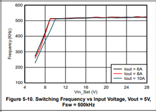

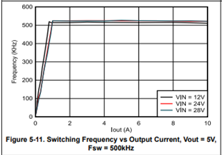

  • Hello Tiger,
    The spec for the fsw min and max values is not listed. Typically we only characterize this for fixed frequency devices. Since this is D-CAP3, we do not characterize this. The frequency will vary around the 500kHz range, I attached some frequency data below for reference.
    Hope this helps. If this helped solve your issue, please don't forget to click "This resolved my issue".
    Thank you,
    Calan

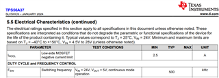

  • Thanks Calan.
    If fact, it is better to provide the spec tolerance in number.
    We cannot judge the spec value from the figure.
    Tiger
  • Hello Tiger,
    Typically we do not characterize this for this device with D-CAP3 control mode. We mainly characterize these for fixed frequency devices, so I do not think we have this data for this device. A rule of thumb is about +/- 10% for frequency, so about 450kHz to 550kHz.
    Thanks!
