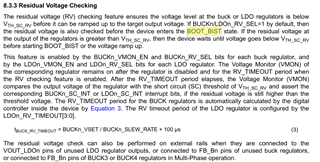

  • Hello Huang,
    There's a lot that was done so it could be numerous things, but it looks like from your readback:  0x0 as responses with ACK on I2C, then this is the RV_SEL being on causing the device to get stuck in BOOT_BIST due to the blocking voltage.
    In short, look for a voltage greater 150mV on any of the power outputs on the PMIC that has the 0x0 as responses.
    BR,
    Nicholas McNamara

  • I can not sure which case are you respond: the soldering error or the program error or both.
    Is this means if any one of output of PMIC is greater than 150mV, than the data are all zero when read from I2C?

  • Yes, this is true, the device is stuck in BOOT_BIST due to the residual voltage.
    Since you confirmed this as a soldering error, I'll considered this thread as closed.
