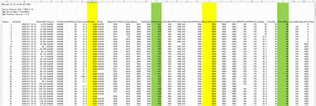

  3. Why does the exported data also appear as "empty" or "abnormally large" data (as shown in the figure below)? What caused it? How can customers better filter out these abnormal data when using MCU to read them?

    2 & 3 - Can you send the log file to better degu the issue.
