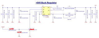

I am struggling to figure out the issues with my TPS62932 circuit. I would like to take 24 V in and buck down to 5 V. I had the circuit working at one point but it seems to be very intermittent. Either one of three states happens:
1) The circuit works as expected (I could only get this working for a short time).
2) When I power-up I can see the output slowly rise to 0.5 V then stays there.
3) The output voltage jumps around seemingly randomly anywhere between 0-5 V. Sometimes it's at 1.5 V, 3 V, 4 V, etc.
Here is the schematic:
Layout:
Inductor part number is Wurth 74439346100.
I'd appreciate any help trying to figure this one out!
