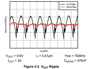

From the datasheet we found that the output ripple after second L-C filter is clean (red plot):
However, we tested around 2-3 mVpp of output ripple.
Would you be able to let us know the test conditions? Thanks

Hi Guang,
This can be due to probing techniques and bandwidth limit on DSO.
