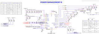

Hi Team,

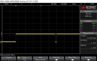

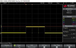

We have build the 100 board using the TI PMIC TPS6522053RHBR and AM6411 processor and on few board PMIC is not genearting any power supply.
To debug the issue we have probed the PMIC GPO2 signal and we have observed that PMIC is trying to turning ON but it fails may be due to some fault. Also same type of behaviour observed with the Buck 2, Buck 3, LDO3 & LDO4.
Also we have used external I2C debugger to read the PMIC registers and below is the I2C dump of PMIC:

Request you kindly check this logs and let us know the exact issue and support to resolve this issue, as we have planned mass production in upcoming quarter.
Below is the snapshot of the PMIC schematic:

  • Hi Mohabbat,
    Thank you for reaching out on e2e and providing all the details.
    Looks like Buck3 RV (Residual Voltage) is causing the PMIC to not power up. It re-tries 2 more times and shuts down.
    Before trying the next power up, can you check the Buck3 output voltage and try to completely discharge and try powering up again.
    Sathish

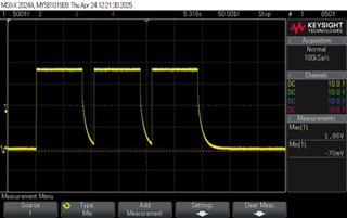

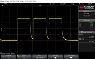

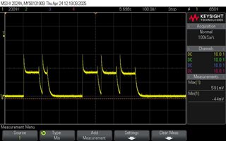

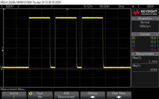

    We have checked the waveform for the below supplies rails:
    BUCK 3:
    BUCK 2:
    LDO 1:
    LDO 3:
    LDO 4:
    We are not observing any output on the LDO 2(VDDAR_CORE) and Buck 1 (VDD_CORE).
    Can you let us know which fault is causing this issue based on the PMIC register dump we have shared and also let us know how to fix this issue. This is the very critical issue and we need to resolve it soon.
    Mohabbat Singh
  • Hi Mohabbat,
    Thank you for the waveforms. All the voltage levels are good except Buck3, it is not able to reach the full 1.1V and it could be because of several reasons like bad inductor, leakage from MCU, board manufacturing issues etc..
    Did you check Buck3 voltage when PMIC is OFF?
    Sathish
  • Hi Sathish,
    We have resolved this issue by applying the additional 22uF capacitor at Buck 3 ouptut.
    So, need your opinion on the exact output capacitor needed for the Buck1, Buck2 and Buck 3 as this issue may occurs on the few boards during production due to component tolerance and due to other factors.
    I am thinking to add one more 22uF capacitor on all the buck output for next PCB revision.

  • Hi Mohabbat,
    This is other thing i was thinking about suggesting.
    Since the buck regulators are configured in High Bandwidth, we need a minimum of 30uF capacitance (after derating) however datasheet says 80uF under ripple specification.

  • Hi Sathish,
    This issue is not resolved fully, as we are seeing PMIC is unable to turn ON each time and during that time we are observing the same buck 3 waveform that i have shared.
    For example, if are trying to turn ON PMIC 10 times then its able to turn ON properly 6~7 times only and for 3~4 times its failing due to buck 3. We have increased the capacitor value to 66uF but still facing same issue.
    Looking for the fix that completely resolve this issue.

  • Hi Mohabbat,
    Increase all the Buck output capacitance to >80uF and check.
    You can also plot all the output rails as shown in TPS65220 TRM power up sequence diagram and check if any other rails are causing the PMIC to not power up.
    Sathish
  • Hi Sathish,
    We have increased the buck 3 output capacitance to >80uF and did the multiple turn ON and OFF cycle and with this change board is powering up successfully each time.

  • Hi Sathish,
    We are observing this issue again on same board, even after mounting the 80uF capacitor and we need the soultion which can resolve this issue fully.
    Mohabbat Singh
  • Hi Mohabbat,
    Is the error related to Buck3 (register 0x32=04) or any new issue?
    When you tried repeated ON and OFF, did you make sure all the rails are completely discharged before starting the new power up? PMIC will engage the discharges before the rails are enabled but if a rail is not fully discharged then PMIC aborts the power up sequence.
