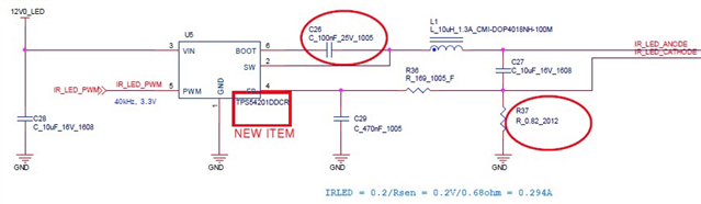

The customer's product has TPS54200 applied, and there are the following defect issues.
- There have been 4 defects so far where REG's GND (1pin) and PWM (5pin) are short-circuited, and all of them have been confirmed to have a burnt phenomenon at the same point as a result of de-cap.
- The customer is continuously trying to reproduce the same defect, but is unable to reproduce it, so he inquired whether it is technically possible to confirm.

  • Hi Grady,
    How many TPS54200 customer had used?
    Can you upload the circuit schematic and PCB layout for checking?

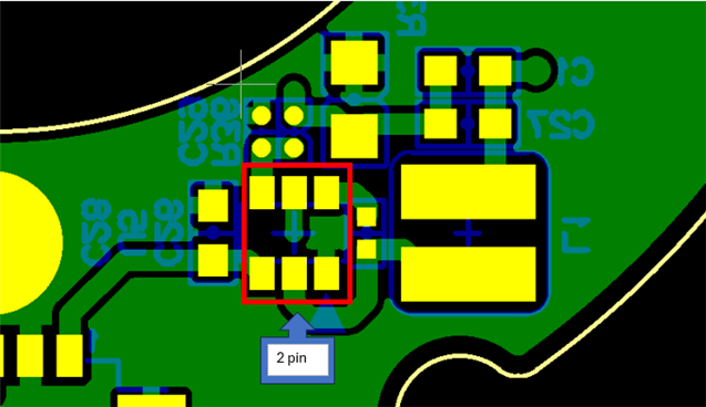

    I am attaching the circuit diagram and PCB layout below.

    The Cin cap placement is good, but its voltage rating should be 25V or higher.

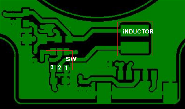

    The SW trace was not routed properly, it should not be placed under the IC package as its strong noise may impact normal operating.

    According to what we have confirmed with customers, there were defects on boards where the SW pattern passes under the IC, but there were also cases where the same defect occurred on boards where the SW pattern does not pass under the IC, as shown in the captured screen below.
    In this case, the same defect symptoms occurred, so if there are any other causes of the defect, please give us your additional opinions.

    On above layout, the Pin1 GND trace was not routed properly which maybe even worse than the SW trace under the IC !
    TPS54200 is a buck converter which require the input cap must be placed very close to VIN and GND pin, otherwise the trace parasitic inductor may generate high spike noise during switching transition, it may cause unstable switching or even EOS damage at high Vin condition.
