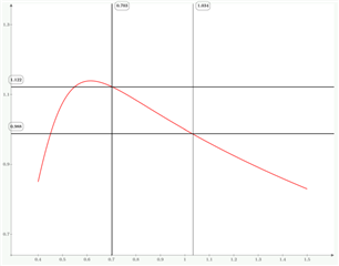

I'm designing an LLC converter with following specifications: -
Nominal Input voltage :- 665V
Minimum Input voltage :- 650V
Maximum Input voltage :- 680V
Vout :- 55V
Pout :- 150W
Consideration,
Resonant Frequency :- 100kHz
Lm/Lr = 5
Q = 0.56
Below are the calculation results,
Turns ratio of Lm = 6
Mg_max = 1.122
Mg_nom = 1.011
Mg_min = 0.988
Cr = 4.8nF
Lm = 2.6mH
Lr = 524uH
With the above values I plotted a graph of 'LLC gain' vs 'Nominal Frequency', the gain curve cuts the 'Mg_max' and 'Mg_min' as shown below,
But, if I consider the tolerances of LLC tank components i.e. 10% for the magnetics and 20% for the capacitor, all the parameters gets changed Lm, Lr, Cr, k and Q.
Q varies from 0.485 to 0.656.
  • Below is the graph with Q as 0.485 and considering tank values changes as well
This graph shows that we are able to achieve the gains with new tank values considering variation i.e Mg_max and Mg_min lines intersect with the gain curve.
  • Below is the graph with Q as 0.656 and considering tank values changes as well
This graph shows that with Q as 0.656 and the variation in tank components the Tank gain is not sufficient enough to intersect with Mg_min and Mg_max.
How can I take care of the variations which are caused by the tolerances of the tank components and also meet the gain requirement?
Can you please suggest any solutions for this?
