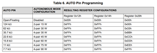

  • Hi Brandon
    Thank you for your response. I have another question. I want to use 5 port; 2 port will be 4 pair (90W) and 3 port will be 2 pair (30W)
    I know with 7.7K all port should be 90W. if ı add 7.7k to pin 52 what will happened to the 2 pair ports?
    Do they supply 30W or they don't work?
    Best regards
    Kerim
  • Hi Kerim,
    Unfortunately, you can only have one base default operation. Therefore, if you intent to have 4-pair 90W ports you will need to keep all ports at this power based on the pin configuration. When the internal ROM of the device boots, pin 52 uses a shot current to measure the voltage to determine the resistance value, based on this resistance value the device will pre-configure according to the above chart, therefore if you place a 7.7kohm resistor you would inherently be changing the equivalent resistance that the device will read.
    If you need to have different configurations per port, I would recommend using the device in AUTO/SEMI-AUTO mode which requires some type of I2C control.
    Brandon

    Thank you for your response. I will use Autonomus mode wirh 7.7K. So I want to be sure about the connection of some pins.

    You may use 0ohm resisters to pull to ground, these are open-drain outputs so not an issue to directly tie to ground. I would recommend 0ohm resistor for proto builds incase you need to probe or test with I2C lines.
    Would recommend 10nF ceramic cap in parallel with 7.7kohm R on auto pin for deglitch.

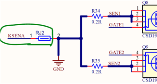

  • Hi Brandon,
    I hope this message finds you well.
    Could you please revieve the schematic?
    RJ1, RJ2, RJ3, RJ4 are net tie I just added them for layout.
    TVS dioedes mnp is SMF58A-E3-08, same as in EVB.
    TPS23881B schematic.pdf
    Best regards
    Kerim
  • Hi Kerim,
    I have transitioned roles within TI but will re-assign this thread to the PoE team and one of their apps experts will take a look. Thank you!
    Brandon
  • Hi Kerim,
    The schematic looks good to me.
    A minor comment that the KSEN wire should be connected very close to Rcs (R34 R35 in below) to ensure good Kelvin connection for accurate current sensing.
    Diang
