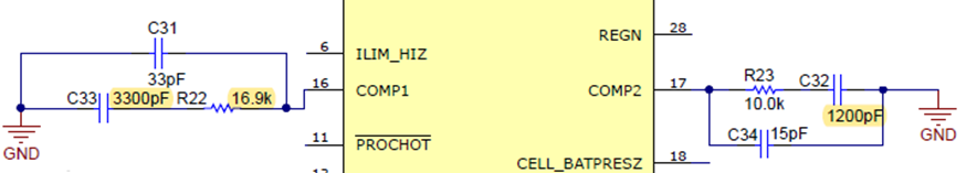

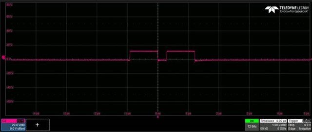

Hi team,

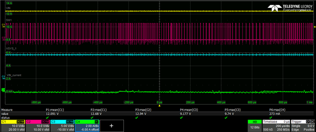

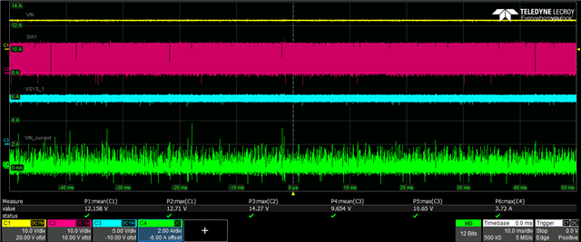

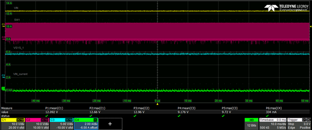

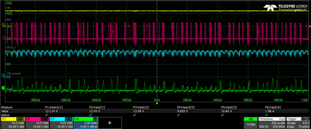

Could you help to check the waveforms below? We can hear the noise while switching.
VIN 12V
VSYS 9V
Battery 3S
Noise waveforms
Normal waveforms

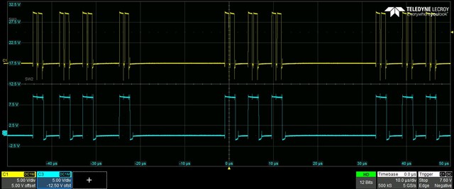

Besides, we can found double pulse in SW1.

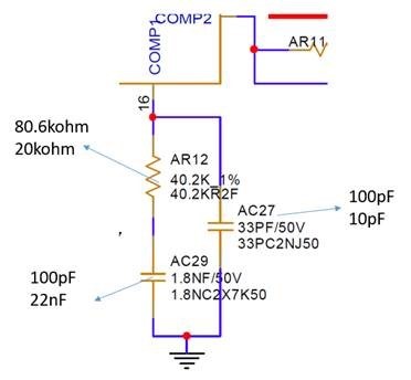

We have tried to adjust COMP1 and the result still the same. There is audible noise.
