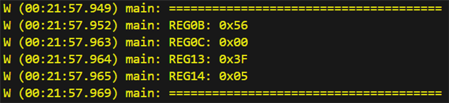

    Sorry for the delay. I was able to modify the firmware so I can visualize the values of the registers you suggested. The problem is that, right now, we're having some rainy days, so the solar panel is able to produce 10 mA of current as much, sadly. So I'll have to wait for the sun to appear, so I can get at least 80 mA of current.
    But, in the meantime, here are the values of the registers 0B, 0C, 13 and 14, with the board powered by my lab power supply:
    I've verified those values with the datasheet, and 0C, 13 and 14 seem right, but there's something strange with REG0B. Because a value of 0x56 means that:
    -VBUS_STAT: 0b010 -> Adapter (3.25 A), which is correct.
    -CHRG_STAT: 0b10 -> Fast charging, which seems incorrect, given that the battery is not even connected in this test.
    -PG_STAT: 0b1 -> Power good, which is correct.
    -RESERVED: 0b1 -> Which seems incorrect, because, according to the datasheet, "always reads 0".
    -VSYS_STAT: 0b0 -> Not in VSYSMIN regulation, which seems correct.
    Is this normal?
    Franco.
  • Hi Franco,
    These register readings all seem fine, there's nothing here to indicate that a input or charge current should be limited. I was looking for something like VINDPM or IINDPM.
