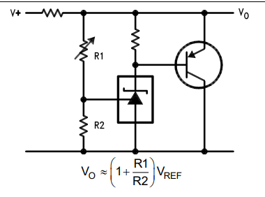

Hi Team,
Customer ask whether series REF can be connect as parallel REF? Like below circuit. Thanks in advance.

Hi Francis,
This is not something that is typically done with a series voltage reference. It sounds like to me, the customer would like to use a shunt reference like above with the higher accuracy of a series voltage reference.
What is the desired output voltage? Additionally, is this being used for voltage monitoring or some other application?
Based off the answers to the questions above, I can recommend the best device and circuit configuration.
