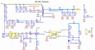

When I plug in my board to AC power, I get regular but slow flickers from my output power LEDs, but then when I unplug the device, it clicks and then VDD is shorted to ground next time I plug the device in.  Any thoughts on how this could happen?

    Do you have a schematic you can share?

    The schematic seems fine with me. I'd increase R6, R10 and R15 as shown below and also add a clamping diode on VDD pin to protect VDD.
    It is always a good idea to share some waveforms so we can understand what happened. If only the IC is broken, you could replace it and repeat the process while monitoring the Vout, VDD, switching node and  Vin.
    As far as the slow flicker of the LED, it means that Vout is not stable and has large ripple. Scope the Vout first.
