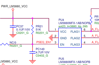

LM3880: How to calculate the delay time with external RC circuit
Part Number: LM3880
I place an RC circuit on the EN pin using a 51K ohm in series with a 4.7uF capacitor, could you please guide me on how to calculate the delay time of flags?
If you could share a calculate tool, that will be greatly appreciated
Sincerely
webber
  • HI
    Why do you need 51K resistor? if you want to use capacitor to delay the EN, you shall just connect the capacitor on the EN and use the formula inside the data sheet
