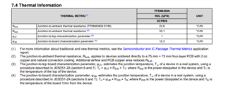

I need a TPSM63606RDLR part , junction to board resistance and Junction to Case resistance (Thermal Data)
The thermal information we provide on this device is what is listed in the datasheet under section 7.4:
Dino
Hello ,
I Requested for a value Junction to case thermal resistance and Junction to Board Thermal Resistance.
In Datasheet ,Junction to ambient Thermal resistance value is only available
vaishali
Hi Vaishali,
All the thermal information we have is in the datasheet, don't have the junction to ambient thermal resistance value.
DIno
