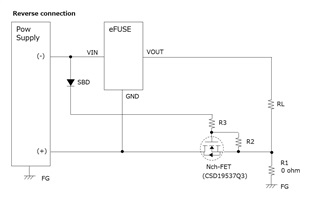

This is a question about protection in case of reverse power connection.
The power return is connected to FG by R1 and must be disconnected when reversed.
I am considering the circuit shown in the figure. Is there any problem?
When connected in the forward direction, the FET turns ON and the device operates, and when connected in reverse, the FET turns OFF and no current flows through R1.
The eFUSE circuit is assumed to be the same as the evaluation board.
