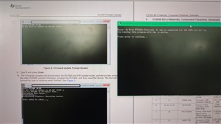

    They have window 10 now.
    I found a previous post here that may help.
    I let them update the EVM FW following the chapter 3 in EV2400 UG. It shows same error as the thread you sent to me.
    BRs
    Kian
  • Hi Kian,
    Are they able to try and update the EVM MCU through another PC potentially? Did they also try using the -s option to update?
