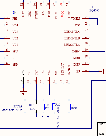

我们使用BQ4050出现了电池温度数据异常大,希望能给我们支持。1000.gg.csv

Hi Han,
Is the abnormal temperature being read from the Temperature() register? If so, please go to the Temperature Enable Register and only enable the TS1 through TS4 pins that are in use. I see in the .gg file, the TS1 and TS4 pins are activated, so please ensure that these thermistors are connected correctly.
We can take a look at the schematic at this time as well.
