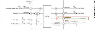

Hello, what is the standard input level for the MODE/STBY pin of the PTPS6521401VAFR PMIC? Can it be directly connected to the PMIC_LPM_EN0 of AM62Lx?
  • Hi Junzhi,
    High-level input voltage for MODE/STBY pin is 1.26 V minimum.
    Low-level input voltage is below 0.4 V.
    Yes, MODE/STBY pin can be directly connected to PMIC_LPM_EN0 of AM62Lx.
