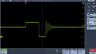

The following circuit is used to step down from 5V to 3.3V.
When operating in discontinuous mode, more than the rated voltage is applied to the SW pin.
In this case, should the absolute maximum rating of the SW pin be based on DC or AC?
Is there any problem if I use it as it is?
Also, what should I do to prevent this?
