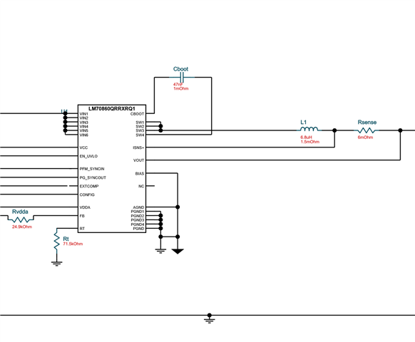

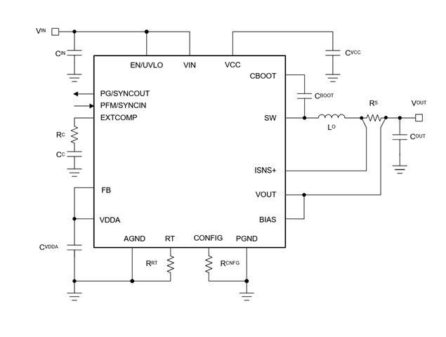

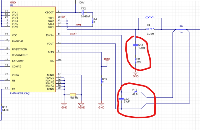

There are some discrepancies between schematic in datasheet, PDF dev board one, and Altium dev board schematic.
In particular Altium dev board schematic has extra components not present in other schematics or Webench suggested design.
1. Snubber circuit (C13, R9)
2. Extra component in current FB (R12, C22).
See attached screenshots.
Please advise if they are necessary and if yes then what are the criteria to choose their value.
