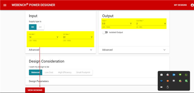

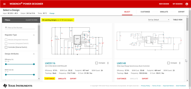

Can you suggest any reference design which meet the following specification,
Vin -30V/10A DC
V out - 15 to 24 v DC (adjustable - planning to vary the FB pin current through DAC)
I out -5-7Amp maximum
Thank you
Aji
  • Hi Aji
    Thank you for reaching out to us.
    Based on your query, we thought WEBENCH Power Designer would suit your requirement.
    Follow below steps to create your desired design on WEBENCH Power Designer,
    Step1: Click on this link to navigate to WEBENCH Power Designer https://webench.ti.com/power-designer/ and Click on "START DESIGN"
    Step2: Provide your desired input and output conditions and click on view design.
    Step3: Browse through all the design in Select Design window and click on "CUSTOMIZE" to open the design.
