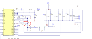

My client is using the TPS543C20A to design the schematic diagram,It was found that a 0R resistor was connected to the RSP and RSN pins. This seems a bit unreasonable. Please help check it. Thanks!
Hi TI team,
By default, R5 is not populated
