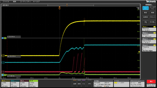

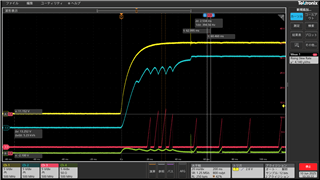

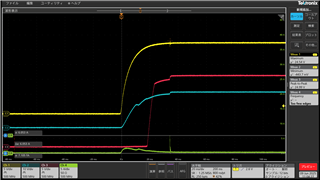

    In the attached waveform, yellow is the original 24V, blue is the 24V connected to the eFUSE which is the latter stage of the inrush current prevention circuit, red is the eFUSE output, and green is the original 24V and the current waveform.
    The resistance of the inrush current prevention circuit is bypassed after about 36ms, so the blue voltage becomes 24V.
    The first image shows the eFUSE output unloaded.
    001
    The second image shows the device with 6Ω connected to the eFUSE output, and after several UVLO cycles it fails to start.
    002
    Could it be that the repeated ULVO state causes the internal temperature to rise, resulting in a thermal shutdown?

  • Hi Kenji-san,
    When you don't have any load, UVLO is also not triggering and device is also performing the startup.

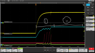

    when the VIN is dropping due to inrush limiting resistor, UVLO will trigger and device will turn off and VIN will recover and device will come out of UVLO. I think you are seeing this and this is expected when controlling UVLO with resistive divider from Vin.
    Can you confirm that the issue is the device is not starting up when Vin is stabilized to high value.

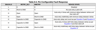

    In the region ii, the input is stable but device doesn't looks like it is retrying. I understand that you have mentioned this above but can you please double-confirm if the NRETRY is set for infinite retries.
    Also you mentioned that with external EN signal, device is able to perform startup. The UVLO won't affect the startup and because your Vin is lower, the device will also have lower power dissipation.
    Also did you try the startup with higher ILIM. We don't want device to hit current limit all the time.

    I have already tried a setting to retry infinitely, and it continues to retry even when the input power enters the stable region.

    You are using a current limiting resistor which turns off in 50ms. You are keeping 4A as current limit and startup load is 6Ohms (24V operating voltage so 4A load). We know that the issue is not due to current limit resistor as in the initial startup when the current limiting resistor is present, the Vin is dropping and causing the UVLO but afterwards when the resistor is disconnected, we still see device failing to startup.
    There is no issue when there is no load. I am expecting similar results for lighter loads like 1A or 2A. I see in the waveform that during failed startup, 2A is the maximum current so the max power dissipation during that time will be around 2A*(24-10) = ~25W-30W which should trigger the startup thermal shutdown in 4-5ms which is consistent with what we are seeing.
    In this scenario, first thing I would suggest is keeping dvdt floating for fastest startup time. I know that you have tried with dvdt values as low at 750pF and that looks like little marginal case. better to check with dvdt floating case.
