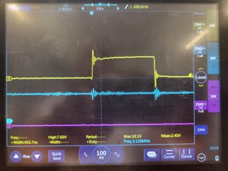

I have desing a step up converter with 12v input and 32 volt output to drive a brushless motor.
Input max current will be appoximate 100A.

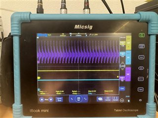

I have do many test with my pcb but when the current on input is more than 60A the noize on the UVLO pin is to much and trigger low voltage contition and close the lm5122.
On the photo is the blue line the UVLO and the green line Low side gate.
As  you can see on the picture i have a noize on the UVLO even if no load applied.(On photo is without load)
When i apply load the noize is much bigger and turn of the lm5122.

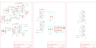

I have upload and my pcb desing
Any idea what is going wrong with my desing?
