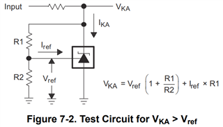

I’m using the TL431 in one of my circuits, but I’m facing an issue where the output voltage isn’t matching my expected value. I suspect I might be missing something in the calculation.
I'm currently using resistors R164 = 1k, R130 = 330k, and R129 = 4.7k, and calculating the reference voltage using a basic voltage divider approach. However, the reference voltage doesn't seem to be what it should be.
Could you please help me with the correct calculation method? Also, is there any specific requirement for the TL431, such as minimum knee current or any other consideration that I should be aware of?
