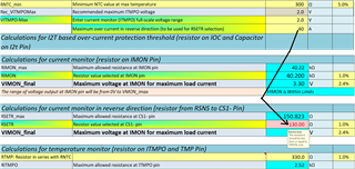

Dear TI support,
We're using the TPS4812-Q1 device and want to allow current in both directions.
In the forward mode everything is working fine. The device trips at the maximum current setting (48amps), and short circuit is working properly.
When we try to switch the current direction by slightly increasing the voltage above the battery source we see the I2t capacitor integrating voltage and tripping the fault and shutting down the the device.
Is there any insight or possible suggestions you can offer to solve our issue?
