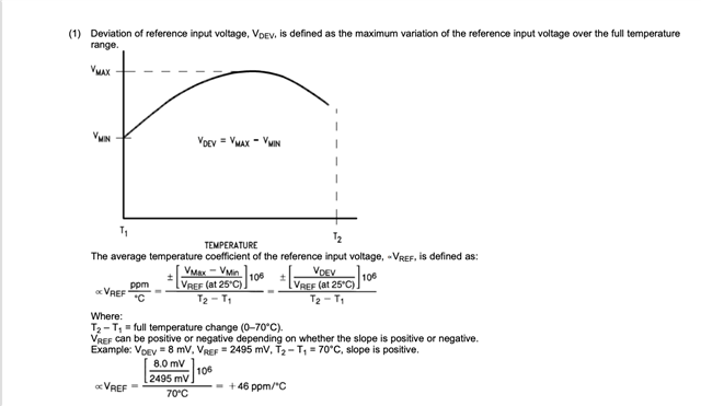

Hi dear,
what is the difference between LM431AIZ and LM431ACZ. pls advise
BTW, pls share the spec compparison for both
Thks
Ani
Hi dear,
Thks
Ani
The differences can be calculated as shown on page 5 of the datasheet
