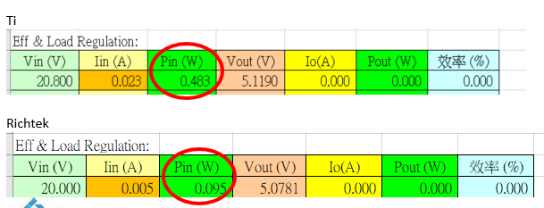

We have test TPS51275B Standby current about Iin = 23mA, it higher than other competior Richtek RT6575.
Is any other way to reduce standby current? Thanks!

No, different with datasheet, our test condition is Ven1=Ven2=3.3V, deivce is enabled, but I can't find this 3.3V/5V both enable condtion standby current on datasheet.
As our test result seems it > 20mA. Is it normal? And if we use TPS51275C can reduce how many standby current, do you have idea for this?

Hi Jeff,
Yes it is normal with Ven=3.3V.
It will not reduce.
