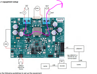

    2. TPS26750EVM and BQ25756EVM -
    How do we connect both these boards and use the combination as a sink to charge a battery?
    - Connect a 140W USB charger to J4
    - Use the same charger to charge the battery by accessing power output from J8 which will then go to the battery
    Is the above configuration/understanding correct? If the battery is connected to J8 then how are we using the BQ25756EVM board as a part of the sink?
    Correct.
    If you take a closer look at the BQ25756EVM and it's connection to the TPS26750EVM, you'll notice that the J8 port connects back to the battery terminals of the BQ2756EVM.
    See the magenta line in the first picture to see the power path from the Type-C port, through the BQ25756, and eventually to the J8 port and battery.
