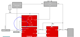

When is POWER_PATH_EN asserted or not asserted? I might be overlooking it but I can't seem to tell from the datasheet.
I'm assuming it is asserted according to the Dead Battery Configuration in Table 7-6 before a configuration is loaded, then asserted after a PD contract is negotiated that meets the required sink PDOs, also taking into account the "Auto Disable Sink Upon Capability Mismatch" configuration bit. What else effects when the sink path is enabled? Liquid detection?
  • Hi Nathan,
    The POWER_PATH_EN pin is used to enable/disable the external high voltage power path (5V - 48V) in both source and sink mode. Here are some example schematics/block diagram on POWER_PATH_EN implementation:
    Let us know if you have any further questions or concerns!

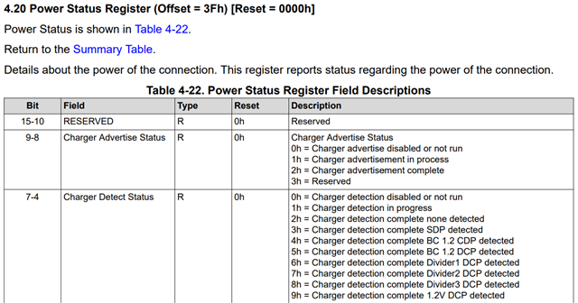

  • Thank you, Raymond.
    How would a BC1.2 implementation work when using the TPS26750 to control a BQ25756 battery charger? Will the TPS26750 set the appropriate input current limit on the BQ25756 automatically?
  • Hi Nathan,
    TPS26750 reports the type of BC1.2 connection made in Power Status register 0x3F. In current implementation TPS26750 doesn't automatically configure BQ25756 INDPM based on BC1.2 detection. TPS26750 only configures the BQ INDPM based on the Type-C and PD current (when applicable).
