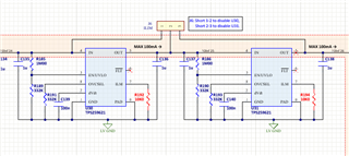

I am using TPS259621 in cascade mode. Vin  = 5V Ilim = 0.1A Please see below for schematic details.
When I measure my current limit, it is only .030A (30mA). Can you please let me know what is wrong with the circuit.

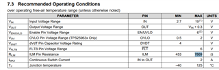

    You are operating the device beyond its current limit capabilities, so unexpected behavior is possible. Can you increase the ILIM and check again.

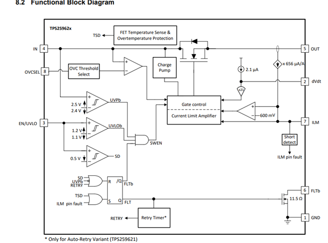

    The device constantly monitors the current and when it exceeds the set limit, it performs the OCP. Here it doesn't monitor for current less than 0.1A but the current monitor circuitry accuracy is not enough to detect the 30mA current accurately.
    Vin can be lower than 5V. You set the EN resistive ladder such than when voltage is above set threshold, EN will get logic high.
