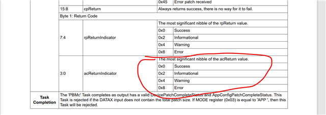

    I reconfigured the hardware to AlwaysEnableSink mode with pinstraps. The PD ctrl powers up in PTCH mode, and I begin the patch process, using a lower region binary file created by the web tool, following through the state diagram in page 90 of the tech ref manual.  I get all the way to sending the PBMc command without error, i receive 0x0 back in the CMD1 register, but when i check the DATAx register, the Output DataX response is not 0, but 0x3 in the acReturn Indicator field.  on all previous 4CC commands with output Datax that i check that register for, i get 0 back.  This doesn't appear to be a case stated in the manual. If I ignore the error, the PD ctrl never leaves PTCH mode and the INT_EVENT1.PatchLoaded bit never gets set.

  • tps26750_patch_log-export.csvexport attached.  I tried to send the beagal export file as well but its not an allowed file type here.
