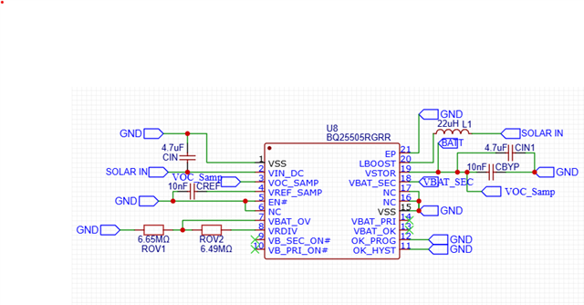

BQ25505: BQ25505 not allowing battery current
Part Number: BQ25505
Hi
I've been struggling with this since 2 prototypes.
I am using the BQ25505RGRR to charge li battery at 3.6v max. When i connect a 3.3v on vbat_sec, I do not see any voltage on VSTOR.
I also changed the applied voltage to 2.5 to 4v with nothing on vstor.
I already tested on 2 different runs and each time 3 boards.
I dont know why this is happening.
I am not using OK_HYST
and not using OK_PROG
can this be it?
