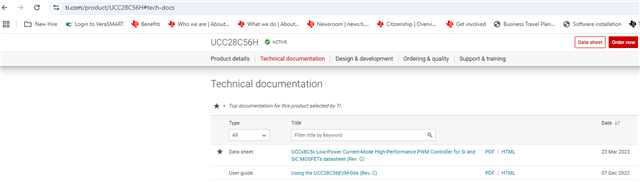

UCC28C56H: 80-1000VDC wide input Flyback controller with 80W
Part Number: UCC28C56H
Hi Team,
(Reposting due to changes in the requirement and inability to respond to the previous thread)
We are developing an isolated flyback converter to be used as an auxiliary power supply in inverter applications. Below are the updated key specifications:
  • Input Voltage: 80 VDC to 1000 VDC
  • Output Voltage: 24 VDC
  • Output Power: 80 W
  • Isolation: Required (reinforced)
After reviewing the available options in the brochure, I have shortlisted the UCC28C56H controller for this application.
Could you please confirm whether this controller is suitable for our requirements?
If not, could you kindly suggest an alternative that can handle this ultra-wide input range and power level?
Thank you in advance for your support.
