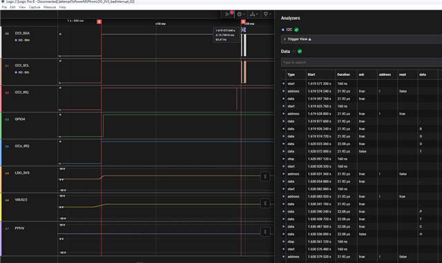

We had a functional design with the TPS25750 internal switch variant. The design has been updated to swap in the TPS25751.
After the swap (new board spin, professional assembly) we cannot communicate with the TPS25751. When writing the address from the MCU over I2Ct to the TPS25751, the address is written (has not changed) 0x21.

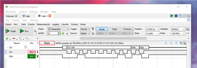

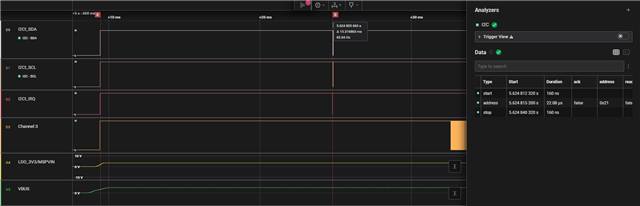

Scoping the I2C bus, we see the MCU is writing to the TPS, and no response is given.
I have done some basic checks, like voltages on the 3V3_LDO is accurate. 1V5_LDO is also reading 1.5V.
Are there any firmware modifications I have to make on the TPS25751 firmware? Does the target address change? Both ADC1 and ADC2 are pulled low with 100K, so I would expect 0x21 to be the address.
